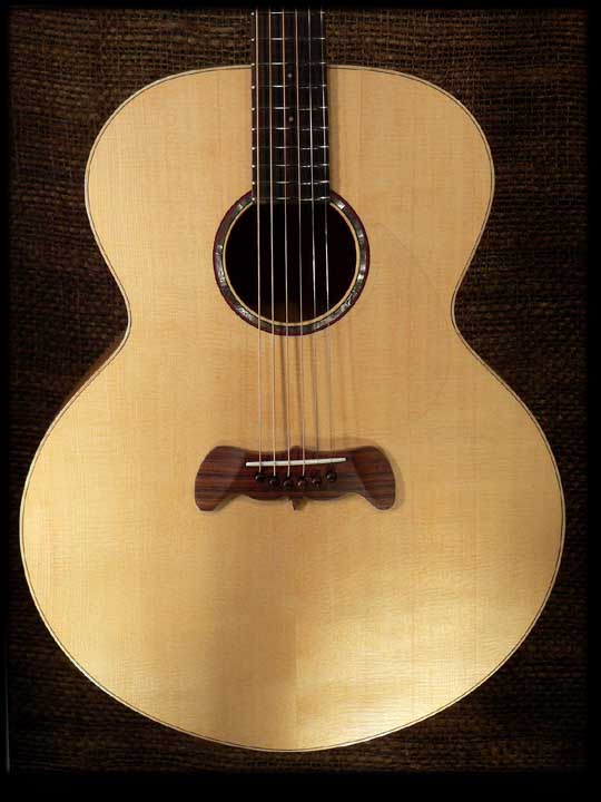

Here's a SJ (or J-185) style acoustic that I just finished up, with a top of the Lutz Spruce that I got from Shane at High Mountain Tonewoods. Pardon my lame pictures, I am still trying to get good ones!
It's got Cherry back, sides and neck and maple binding.
It's really opening up already! I'm very happy with the tops, thanks Shane! I'm not too good at describing what a guitar sounds like in this way, but it has a good balance of sparkle and low end- I was almost more surprised by the sparkle and clarity than I was with the bass response, which also was more than I'm used to because I typically build smaller guitars. Lately I've done a couple of these. This is the first with Cherry, and the first with Shanes' tops which seem to be an improvement over the earlier ones I'd made.
Mark Swanson
Swanson Guitars

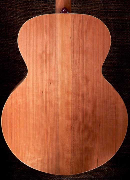

Posts: 575
Here's the Cherry back...

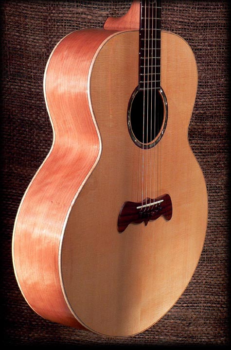

Posts: 575
A side view...

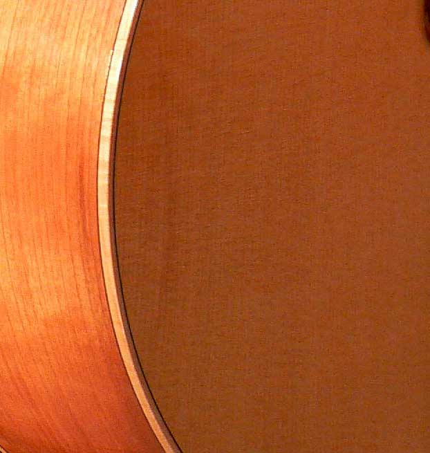

I will try to show a couple of closer pictures...This one shows the binding edge. I love this quartersawn Cherry, it's very pretty when cut this way.
Mark Swanson

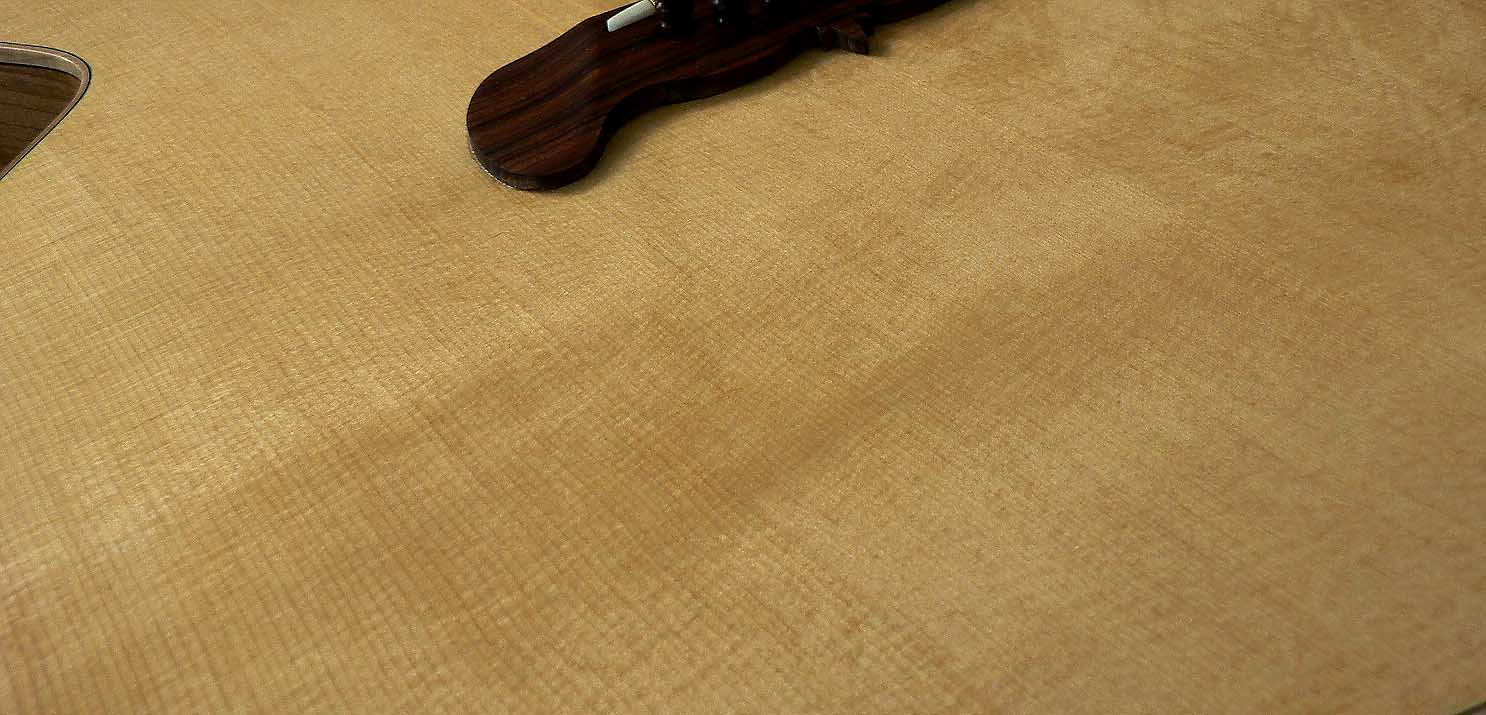

Posts: 575
That pic doesn't show the fineness of those tops! This one shows the grain of that killer spruce.

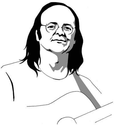

Posts: 575
Last I'll post the peghead. I made this guitar for a friend of mine as a gift, and I attempted an engraved inlay of him here. I had help from my friend Dan Sharp, a very good artist, with turning a photo into this design. I am still learning engraving- can you tell??!
Friends don't mind of you practice on their guitars!
Here is the photo of this hippie guy...
And this is the result of Dan's help with the photo- thanks, Dan!

Very nice! I love cherrywood.... That lutz sure looks good too... Very nice rosette...

Mark - very nice! Your work is very tastefully executed. I too like Cherry guitars. BTW: the inlay is an excellent likeness.
Quesion: what grade of Lutz is that?

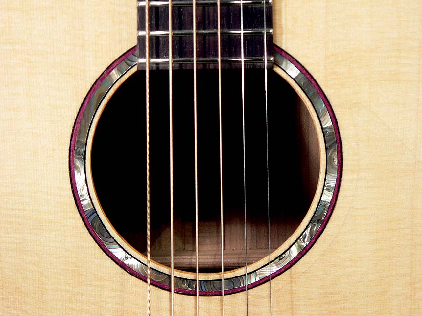

Shane will probably drop by and tell what grade the spruce is- All I know is it's sweet! It is the first time I've used his wood.
I might as well post a pic of the rosette, too.
I get all my abalone right from the shell. I get the shells anywhere I can, I have a stash that got from an abalone fisherman out on the west coast. I cut them up with a wet-saw, and then I work them down into blanks on a grinding stone of the type used for stonework. I've been doing that for a long time and I learned how to do it from Jim Patterson's book, Pearl Inlay.
The shell that I used for the peghead inlay is river mussel, I gathered the shell myself from the Grand River here near my home. Some of it is very white, and other shells are pink and you can see the two colors in the face.

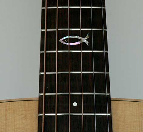

Posts: 575
Here's the 12th fret inlay....

Posts: 575
I'll take a pic, and let you all know what he said. That would be fun!
I put the fish on there because he had once asked me to inlay one on his D-18- and I refused! The trussrod cover is also carved to suggest a fish.
